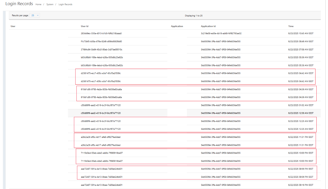

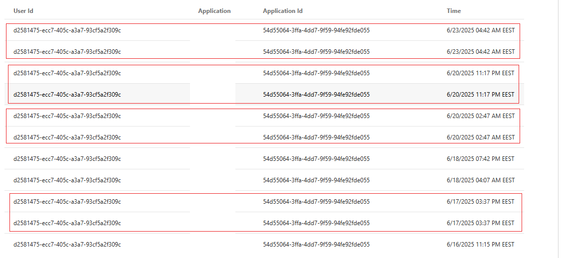

      In most (but for some reason not all) cases when user logins using FA login page via OAuth there are two records in admin FA login records, why is this happening and how to fix it?

          @sergey_smirnov, I see you submitted the FusionAuth log. I didn't approve the post because I thought there might be some info in there you don't want public. I cut some out and will paste it here:
          That is interesting. Would it be possible to get the web server logs and see if there were actual multiple requests.

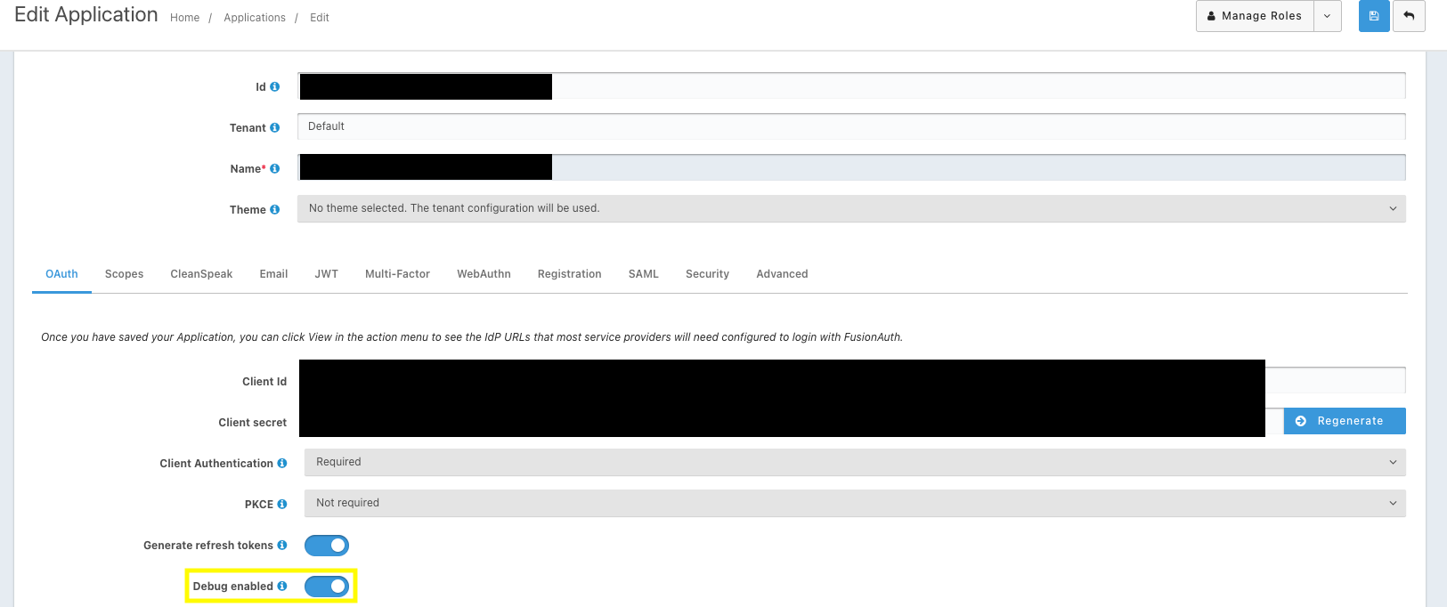

                @sergey_smirnov You won't find the web requests in the FA dashboard, but you can enable debugging for Oauth in the application and see if that gives you more details in the System -> Even Log.
