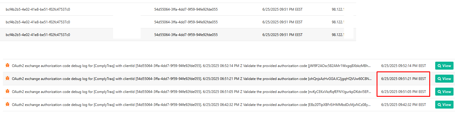

      @sergey_smirnov, I see you submitted the FusionAuth log. I didn't approve the post because I thought there might be some info in there you don't want public. I cut some out and will paste it here:

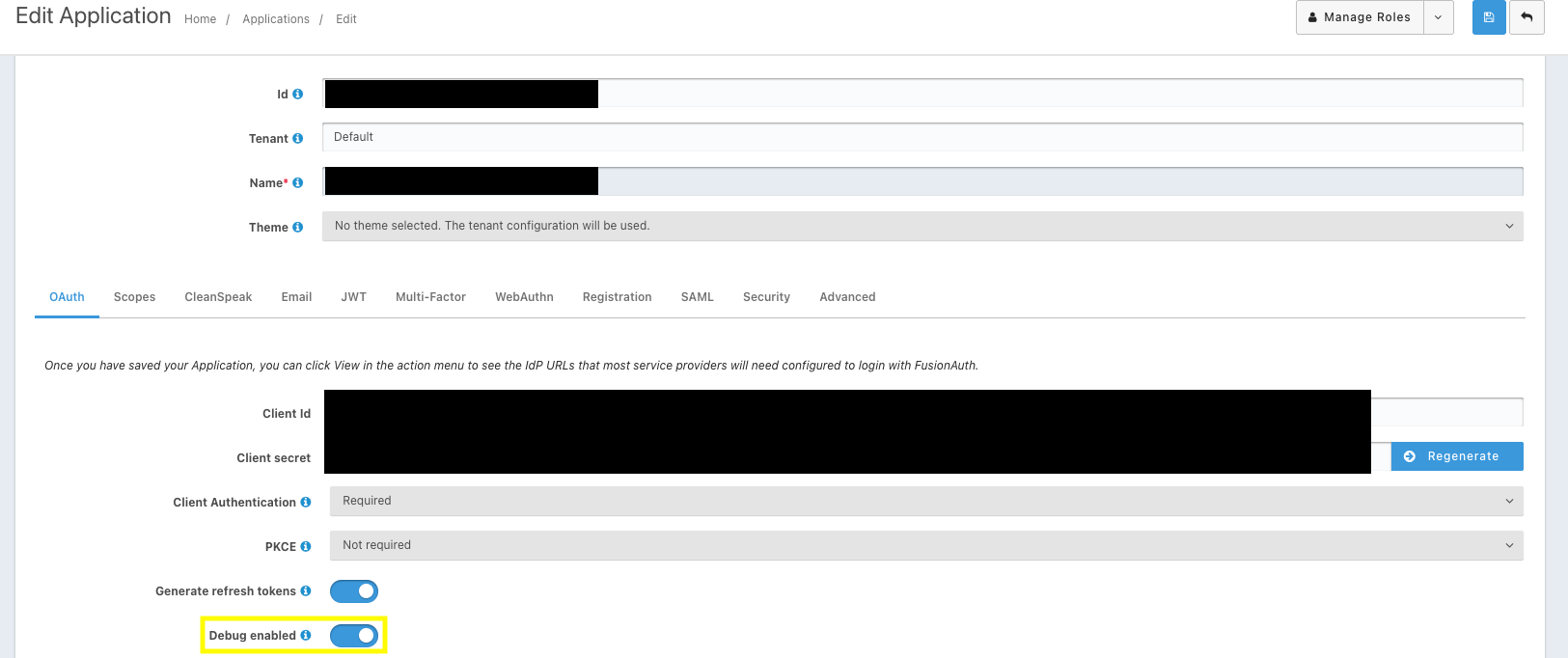

            @sergey_smirnov You won't find the web requests in the FA dashboard, but you can enable debugging for Oauth in the application and see if that gives you more details in the System -> Even Log.
            S 2 Replies Last reply Reply Quote 0

              We have the following records in event log for doubled logins at the same minute:
              OAuth2 exchange authorization code debug log for [******] with clientId [XXXXXXXX-XXXX-XXXX-XXXX-XXXXXXXXX055].
              6/25/2025 07:17:54 PM Z Validate the provided authorization code [VqER3sOWcAn2RuONY0BPHK-_TAt3hb1y92fwwj8mDNY].
              6/25/2025 07:17:54 PM Z Validate PKCE code_challenge [crUqHYRAXwg-yyUFsei4-I9rmZ1SQiz0sC76ARgPtYA] provided during the authorization request with the provided code_verifier [pDyk_bw-BKUPyCfpTcVn694YoutV9_2gH0yIP09710g]. Calculated code_challenge [crUqHYRAXwg-yyUFsei4-I9rmZ1SQiz0sC76ARgPtYA].
              6/25/2025 07:17:54 PM Z Scopes requested [openid profile email]
              6/25/2025 07:17:54 PM Z Ensure the provided request parameters match those provided the authorization request.
              6/25/2025 07:17:54 PM Z User is registered for application with Id [XXXXXXXX-XXXX-XXXX-XXXX-XXXXXXXXX055] the [roles] and [applicationId] claims will be added.
              6/25/2025 07:17:54 PM Z The authorization code has been successfully exchanged for an access token.
              6/25/2025 07:17:44 PM Z Validate the provided authorization code [BjWl6NxsoTZG_wqCOaBegQzWbDI8WBnid4sPQDk9eCM].
              6/25/2025 07:17:44 PM Z Validate PKCE code_challenge [h-n3xKiN9XmcWtJOBbALv6S4Rf9w-LSeuFgoxJIT8bU] provided during the authorization request with the provided code_verifier [ptFznenHB4Mq4fhsRi-h77GPA1XCkWgl2XpPAPYJaK0]. Calculated code_challenge [h-n3xKiN9XmcWtJOBbALv6S4Rf9w-LSeuFgoxJIT8bU].
              6/25/2025 07:17:44 PM Z Scopes requested [openid profile email]
              6/25/2025 07:17:44 PM Z Ensure the provided request parameters match those provided the authorization request.
              6/25/2025 07:17:44 PM Z User is registered for application with Id [XXXXXXXX-XXXX-XXXX-XXXX-XXXXXXXXX055] the [roles] and [applicationId] claims will be added.
              6/25/2025 07:17:44 PM Z The authorization code has been successfully exchanged for an access token.

                Also we have 3 login records and only 2 corresponding entries (for the same minute) in event logs:

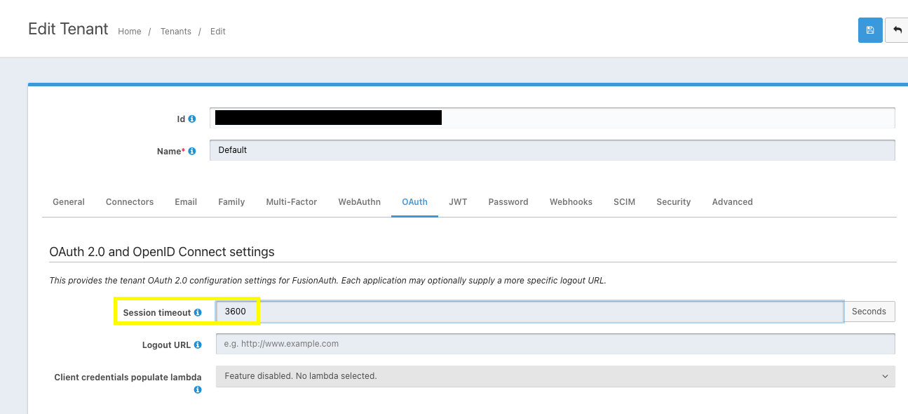

                    There is a setting in the Tenants for the Session timeout.
                    Tenants -> Edit -> OAuth tab -> Session timeout
                    Let me know if you are able to log the users page views.

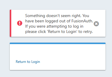

                        sergey_smirnov @mark.robustelli
                        @mark-robustelli
                        Sometimes user sees this:
