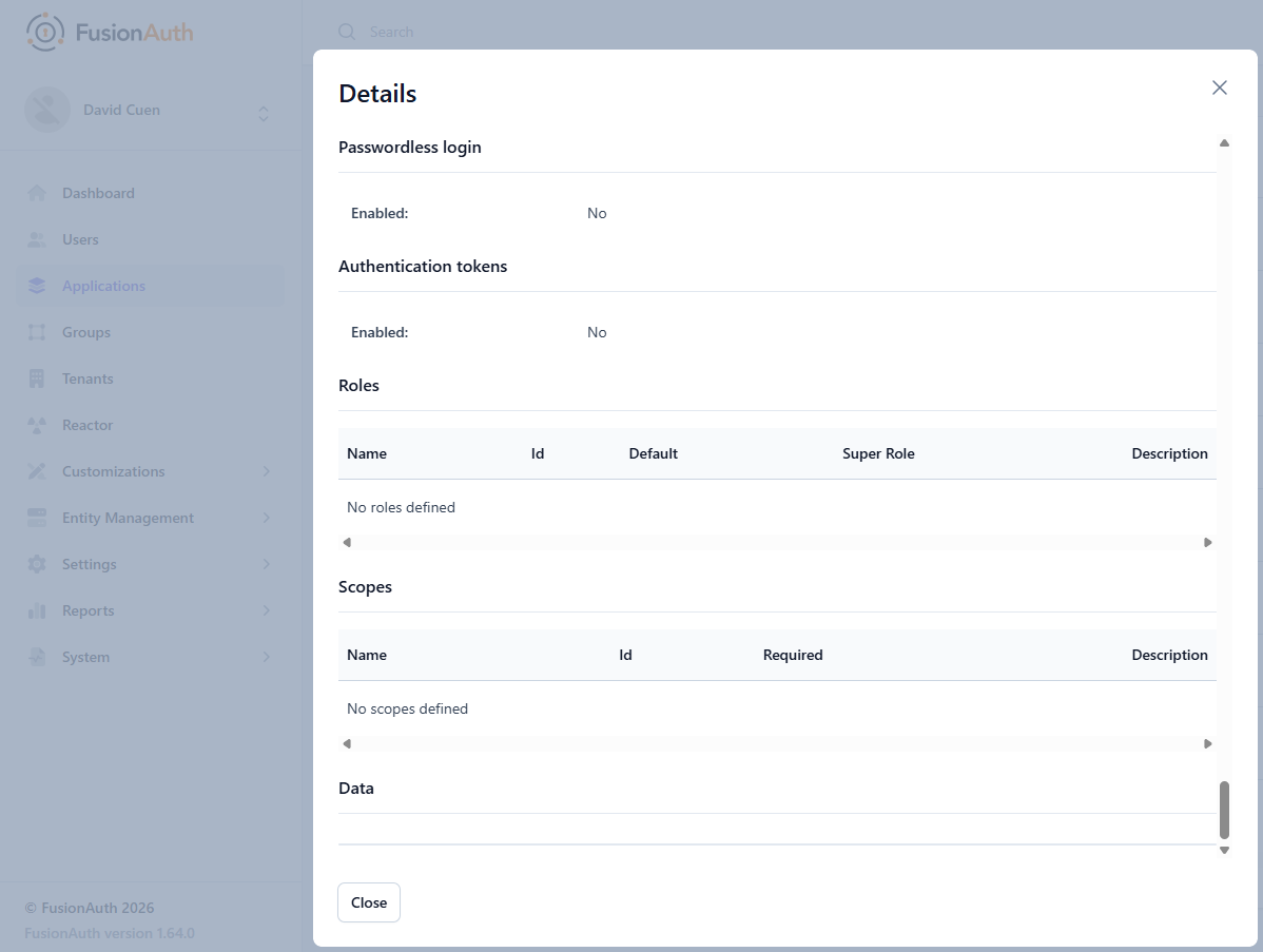

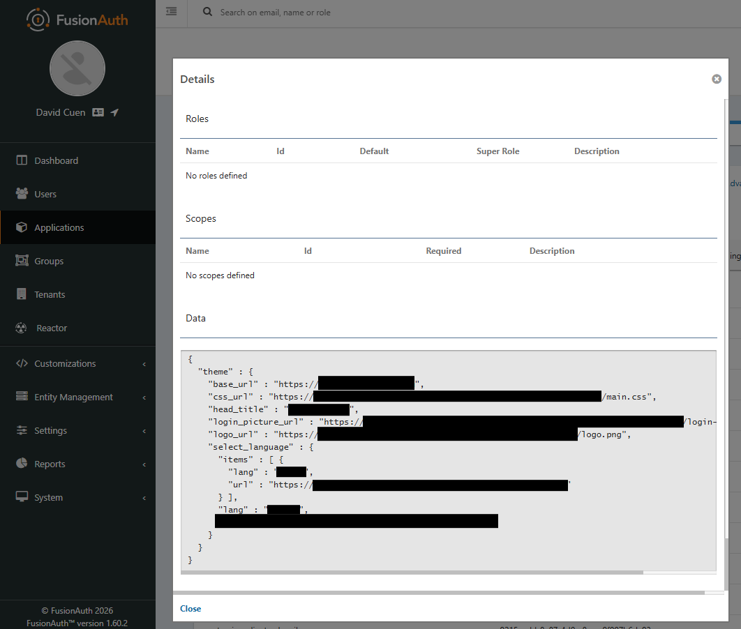

    Applications data is not displayed in the admin UI details view in versions later than 1.60.2
    670
    • D
      david.cuen
      In versions later than 1.60.2, when viewing the recorded data details for an application in the admin UI (Applications > Select > View), the existing data information is displayed as empty
      1.60.2
      1.64.0
