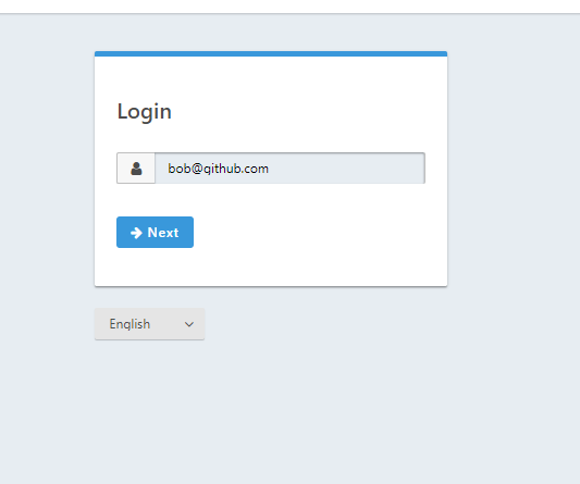

          The Lookup API is generally designed for use when you are not going to use the FusionAuth login pages or SSO features.
          I think you're asking to go directly to an IdP login page without hitting the FusionAuth login page first and clicking a button to "Login with Acme Corp" for example?
          Does this issue cover your use case?
          https://github.com/FusionAuth/fusionauth-issues/issues/178#issuecomment-501390468
          The above issue would allow you to provide a hint ahead of time so we can bypass the login page for a domain scoped IdP configuration. We could also add the option to provide the Identity Provider Id as a hint on the request ?identityProviderId=42 to force a particular IdP.

                                Well, coming down the pike in 1.19.0 is a feature that may be of interest to you.
                                From the release notes:
                                IdP and Email hinting for the FusionAuth login pages. This feature will allow you to optionally bypass the login page and go directly to the third party IdP based upon the user’s email address or a suggested Identity Provider Id.
                                I don't know exactly when 1.19.0 will drop, but it'll be soon.
