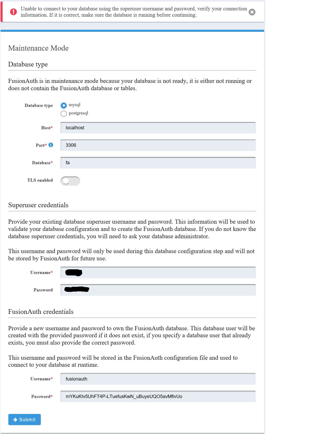

      New setup and keep getting Maintenance Mode after the first step completes. It goes into creating the schema and I can verify that they were created but then goes right back into maintenance mode. When I try to login again it give me the following error:
      Unable to connect to your database using the superuser username and password, verify your connection information. If it is correct, make sure the database is running before continuing.
      Every time and I can't get passed it even though I verify it's using the database administrator account. I've blown away the DB twice and retried but same problem. Windows 10 server 2016.
      What more information should I provide for assistance?
