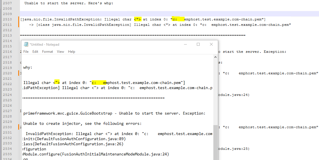

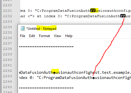

      Scot @mark.robustelli
      the "illegal character" in the log looks different depending upon which text editor is used. As far as i can tell there is no unicode or hidden character at these locations.

          @Scot After digging in a bit, I was able to successfully run the startup script with:
          fusionauth-app.https.private-key-file=C:\ProgramData\FusionAuth\fusionauth\config\host.test.example.com-key.pem
          If I try to run with:
          I get the ConvertFrom-StringData : parsing "C:\ProgramData\FusionAuth\fusionauth\config\host.test.example.com-key.pem" - Unrecognized
          escape sequence \P.
          error.
          I think the double backslashes work. After looking at your first post again, it looks like you are trying to use fusionauth-app.https.certificate. According to our docs, Note, this property will take precedence over fusionauth-app.https.certificate-file if both values are set and we don't need both.
          For the purpose of troubleshooting, let's only use one. Let's start with the file. Clear out the values for the .certificate and .private-key and only populate the certificate-file and private-key-file. To be safe, let's remove all the commented one's out as well. Your config should look something like:
          fusionauth-app.https.enabled=false
          fusionauth-app.https.port=9013
          fusionauth-app.https.certificate-file=C:\\temp\\host.test.example.com-key.pem
          fusionauth-app.https.private-key-file=C:\\ProgramData\\FusionAuth\\fusionauth\\config\\host.test.example.com-key.pem
          fusionauth-app.https.certificate=
          fusionauth-app.https.private-key=
          My instance spins up with that type of configuration. Let's see if yours does as well. Let me know how it goes.

                    • S
                      Scot
                      As a control the FusionAuth website does work with https disabled, but I'm needing to enable https SSL with a certificate.
                      fusionauth-app.https.certificate-file=c:\\temp\\host.test.example.com-chain.pem
                      fusionauth-app.https.private-key-file=c:\\temp\\host.test.example.com-key.pem

                      • S
                        @mark-robustelli said in SSL certificate settings when hosted on Windows:
                        @Scot Does that mean you got it working?
                        No its still not working for me. I was trying to emphasize TRUE with uppercase letters in the settings i'm testing, but then ran into the issues that FusionAuth's settings are Case-sensitive and must be lowercase.
                        mark.robustelliM 2 Replies Last reply Reply Quote 0

                            mark.robustelli @Scot
                            @Scot OK, I got this fully working. This is going to be a long post, but I will try to be as detailed as possible. I would recommend testing with this and see if you can get it going. I did a lot of testing and one of the things I noticed was that the keys have to be in the right format. I would get it running like this. Then substitute your keys and see if it works. If not, there may be something off with them. Let me know how it goes.
                            And I will say this for anyone reading. DO NOT USE THE CERTS IN THIS POST IN PRODUCTION. I WOULD NOT EVEN USE IT BEYOND THIS INITAL TEST. THE WHOLE WORLD CAN SEE THE PRIVATE KEY.
                            Step 1: Install and run OpenSSL (I just added C:\Program Files\Git\usr\bin\ to my Path) openssl.exe
                            Step 2: Generate the root private key
                            (Running Powershell as Administrator)
                            I created a new folder under the C:\fusionauth folder named "cert"
                            cd C:\fusionauth\cert
                            Ran this command
                            openssl genrsa -out fatest5.key 4096
                            Step 3: Create a self-signed certificate
                            in the C:\fusionauth\cert folder run this command:
                            openssl req -x509 -new -addext "subjectAltName=DNS:localhost,DNS:.localhost,IP:10.0.0.1" -nodes -key fatest5.key -days 3650 -out fatest5.pem*
                            Note:
                            The first time I ran this, I received "Can't open "C:\Program Files (x86)\PostgreSQL\psqlODBC\etc\openssl.cnf" for reading, No such file or directory"
                            I executed the following and then retried creating the certificat i.e. openssl req ....
                            needed $env:OPENSSL_CONF = ''
                            I was asked for some input and here are the values I used. I image you could enter whatever you want.
                            Country Name (2 letter code) [AU]:US
                            State or Province Name (full name) [Some-State]:CO
                            Locality Name (eg, city) []:Denver
                            Organization Name (eg, company) [Internet Widgits Pty Ltd]:FATest
                            Organizational Unit Name (eg, section) []:FATestUnit
                            Common Name (e.g. server FQDN or YOUR name) []:localhost
                            Email Address []:none@example.com
                            Step 4: Verify the following files exist
                            C:\fusionauth\cert\fatest5.key (See Below for text of files from my example)
                            C:\fusionauth\cert\fatest5.pem (See Below for text of files from my example)
                            Optional Step 4.5
                            Import C:\fusionauth\cert\fatest5.pem to your Trusted Root Certification Authorties
                            This is not required but your browser may complain that the certificate is invalid when you go to check running site. The scope of the import is beyond this issue, but if you need help doing so just let me know.
                            Step 5: Edit Config file (I used Notepad++)
                            C:\fusionauth\config\fusionauth.properties (full text below)
                            fusionauth-app.https.enabled=true
                            fusionauth-app.https.certificate-file=C:\\fusionauth\\cert\\fatest5.pem
                            fusionauth-app.https.private-key-file=C:\\fusionauth\\cert\\fatest5.key
                            Step6: Start FusionAuth
                            PS C:\fusionauth\bin> .\startup.ps1
                            A small note, when using the cert, the spin up time took a bit longer, up to a couple of minutes.
                            Step 7: Verify
                            Visit https://locaIlhost:9013
