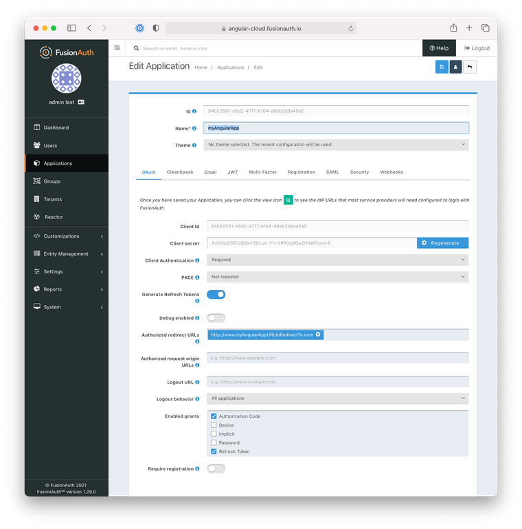

                I am not sure we have exact documentation to showcase setting up communication between FusionAuth hosted in the cloud and another service (such as Angular or Node/Express) hosted in the cloud as well. That being said, the mechanics should be the same between a locally run app, and a cloud run (with a few tweaks to point everything correctly to the cloud). For instance, in our five-minute guide, we have a locally developed node/express application using OAuth. Theoretically, you could deploy this application in AWS or Heroku (for instance) and modify the Login link to point to FusionAuth in the cloud.
                 a(href='http://localhost:9011/oauth2/authorize?client_id='+clientId+'&response_type=code&redirect_uri=http%3A%2F%2Flocalhost%3A3000%2Foauth-redirect&scope=offline_access&state='+stateValue+'&code_challenge='+challenge+'&code_challenge_method=S256') Login
                    a(href='https://<<your-deployment-url>>/oauth2/authorize?client_id='+clientId+'&response_type=code&redirect_uri=<<your_redirect_url_encoded>>&scope=offline_access&state='+stateValue+'&code_challenge='+challenge+'&code_challenge_method=S256') Login
                And then you would configure FusionAuth in the cloud to return back to your node/express application using the OAuth tab under applications (the redirect URL, likely).
                I was able to spin up a test cloud deployment, change the link in our NodeJS application (locally), and be successfully logged in (in FusionAuth cloud) and redirected to the redirect URL that I specified (an angular app, in your case).
