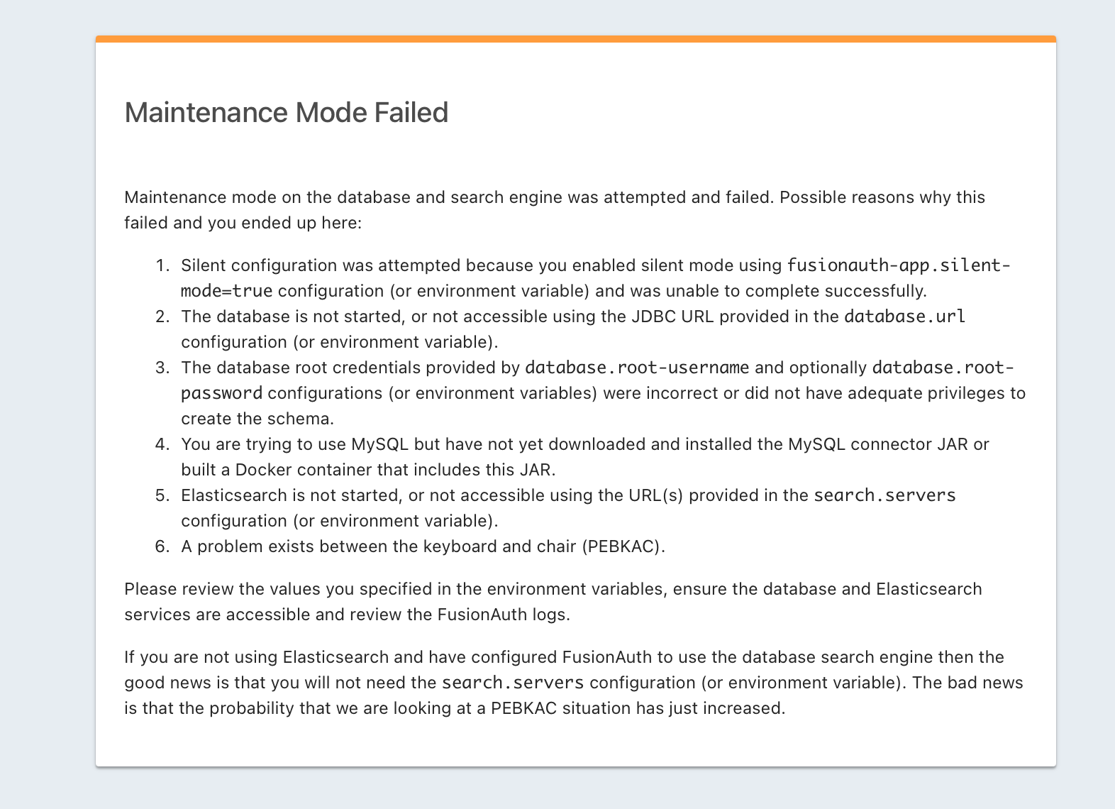

      Hi,
      We have upgraded our Azure managed DB from 13.x to 16.8, and our Docker system started to give an error during the boot. It looks like FusionAuth is trying to install or migrate to a new version and writes logs as it is creating already existing tables with data in them. We also gave it a try to set the Docker version from 1.51.1 to 1.53.2 with the hope of getting rid of that error, but with no luck.
      What would be the reason?
      • A
        atakan
        After disabling the silent mode, the error has changed to table ownership issues. We granted FusionAuth users to table owners db-wide, and it fixed the problem. Why it appeared after the Azure DB upgrade, we don't know yet.
