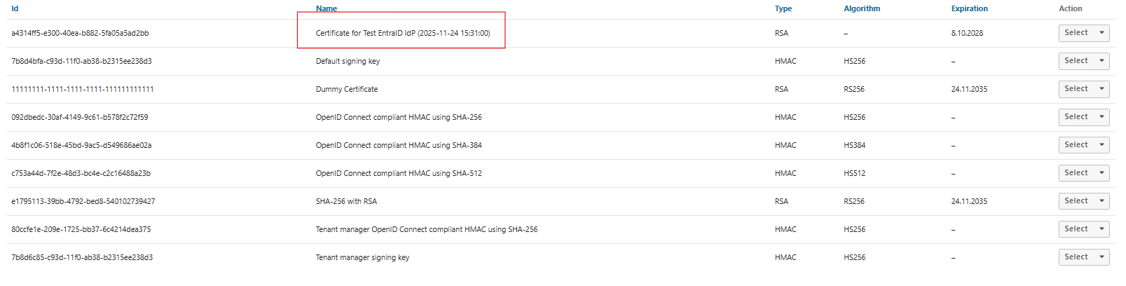

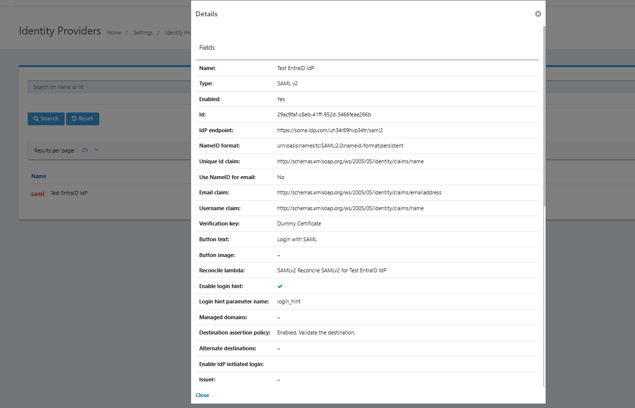

              @mark-robustelli Well, here are some screenshots:
              • at first I added a new IdP - via API POST /api/identity-provider - and the existing dummy/placeholder certificate is linked:
                -> this is the only IdP
              • then I import - via API POST /api/key/import - the correct certificate:
              • but I do not link this in the IdP, and so do not set the Verification key
              Do I get it right, that the login should not work in that case? But I am able to login via this EntraID IdP.
