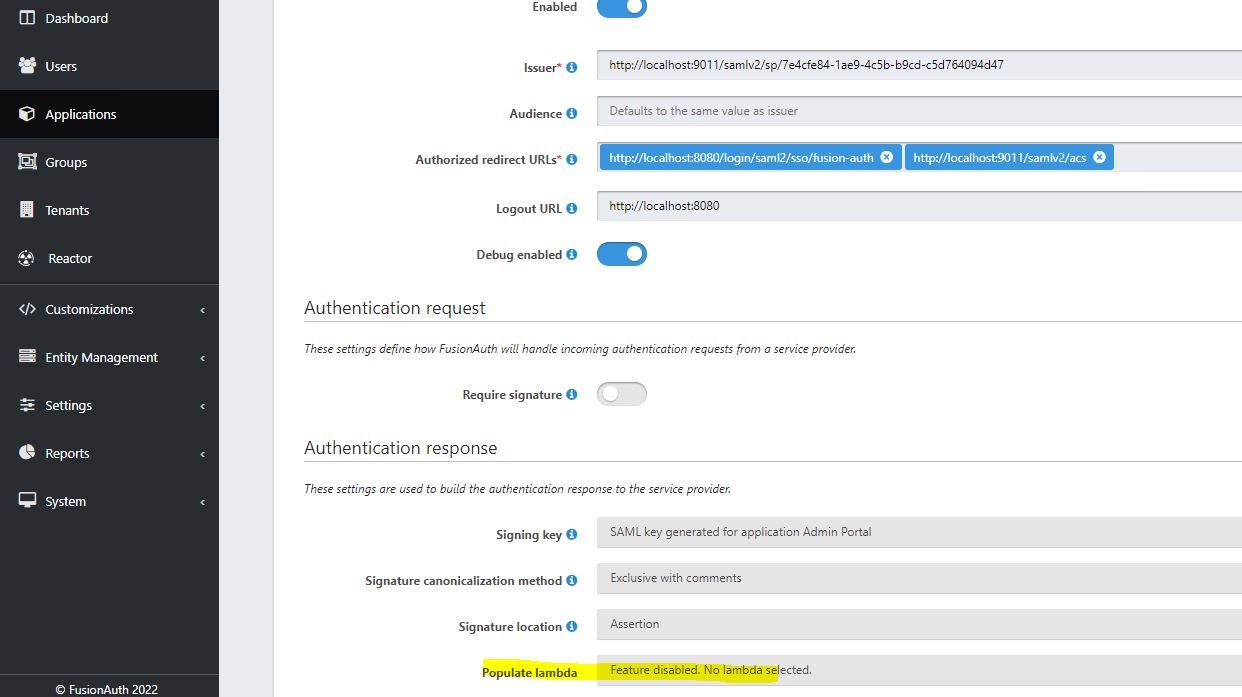

I figured out that we can use lambda to set extra parameters into the SAML response:
https://fusionauth.io/docs/v1/tech/lambdas/samlv2-response-populate
but the lambda feature is disabled
Note: I'm using community edition

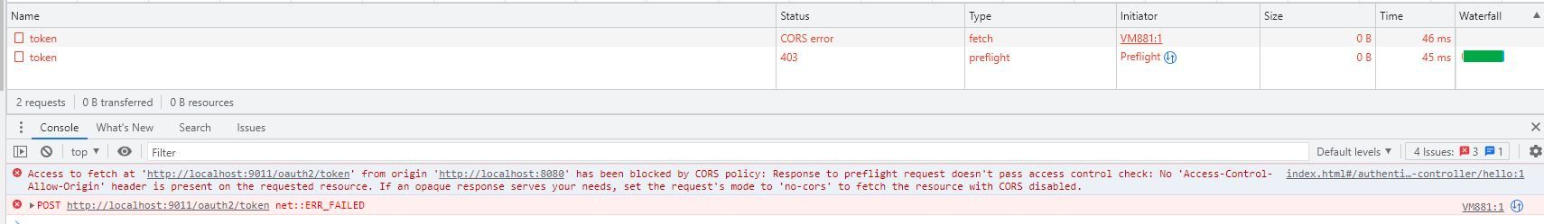

This is all what the event log says:
It seems there is a similar issue reported here:
https://fusionauth.io/community/forum/topic/835/cors-error-when-posting-to-oauth2-token/7
It's working when I use postman

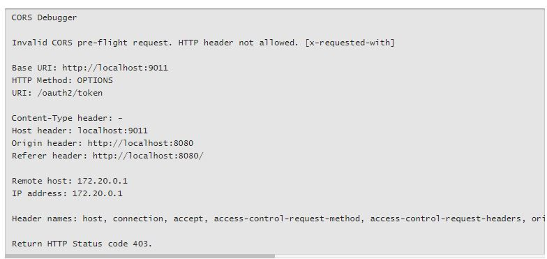

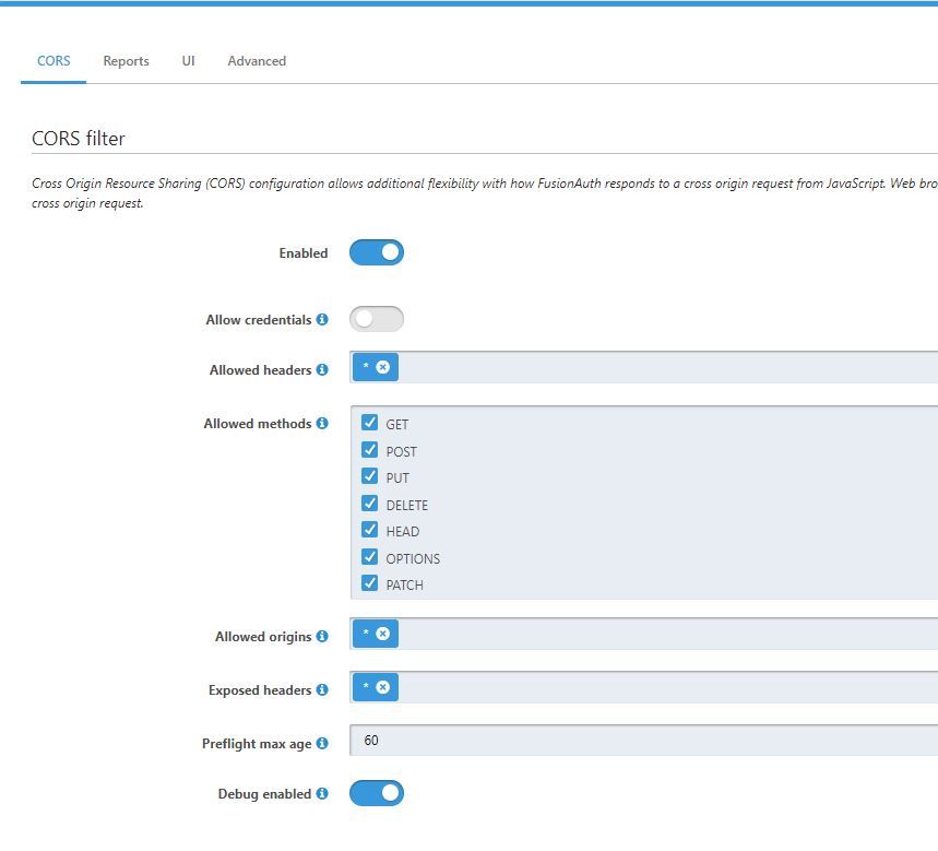

I have an issue with CORS when trying to access the oauth2/token endpoint
I tried disabling CORS but it doesn't work

The lambda I mentioned is the one in SAML tab in Application Setting:

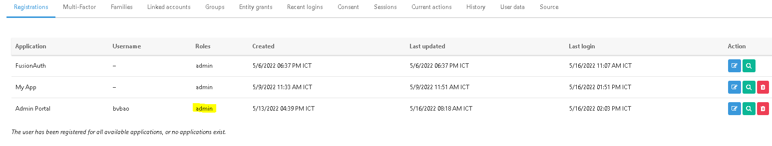

Here is the role assigned to the user
Note: when I use oauth2, I can retrieve the same role

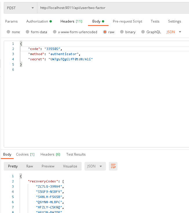

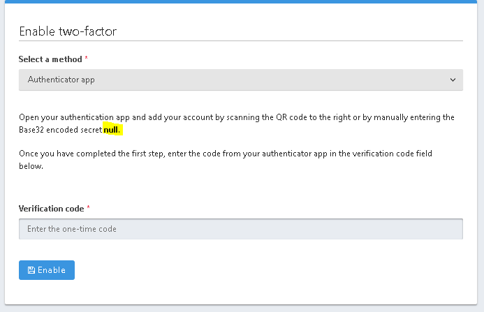

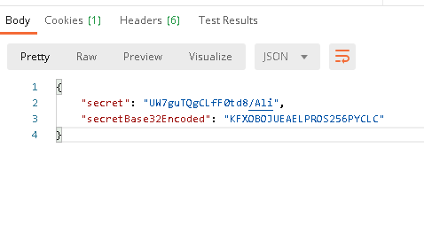

I try to enable two-factor using authenticator app, but the secret is null
It is OK when I use API
Note: I'm using the community version
