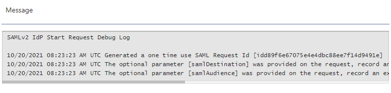

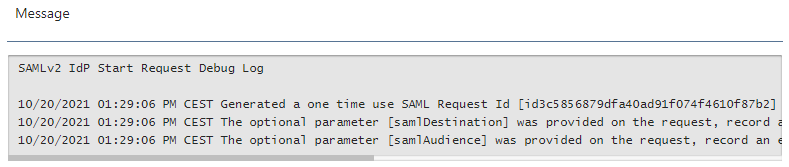

    • SAML invalid timestamp.
      Hi!
      Situation:
      Few months ago my I set up a FA installation hosted in FA servers. Then I set a SAMLv2 IDP configuration, and in the end ran perfect.
      Now I set the same configuration for the same IDP in a FA installation (1.27.2) hosted in our servers.
      However, this configuration does not work correctly this time. I have contacted the IDP manager, and he said that the timestamp in the AuthNRequest is invalid. So, I checked the server and database timezone configurations, and set everything to UTC, as SAMLv2 demands, and then rebooted everything. No effect from this.
      Then I realized that the event logs in the FA server shows a different time (UTC) from ours (CEST).
      FA hosted server:
      Our server:
      Do you have any ideas on how I can change or set that timezone? Since I think this is the reason why the SAML conection is not working.
      Thank you!
