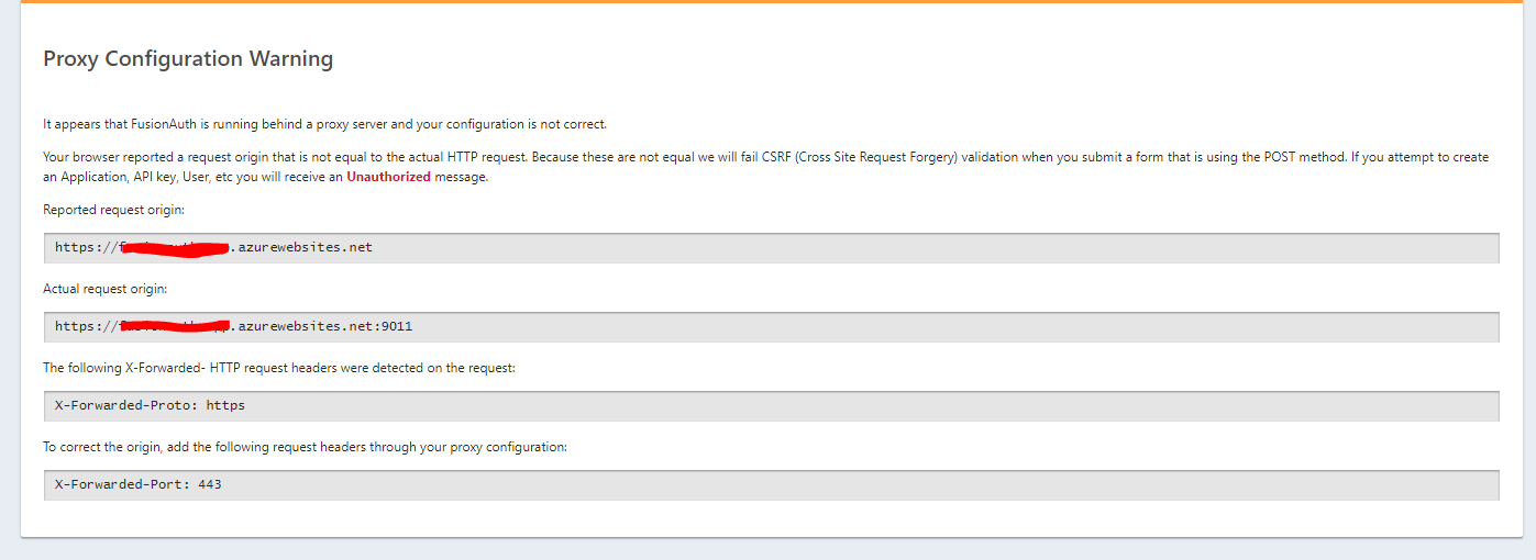

Thanks @dan, indeed I routed traffic through application gateway and it worked out

Hey, I want to host fusionauth from docker image on azure app service for containers. I have adjusted the docker-compose file. Here it is:
version: '3' services: fusionauth: image: fusionauth/fusionauth-app:latest environment: DATABASE_URL: jdbc:postgresql://***.postgres.database.azure.com:5432/fusionauth DATABASE_ROOT_USERNAME: postgres DATABASE_ROOT_PASSWORD: *** DATABASE_USERNAME: fusionauth DATABASE_PASSWORD: *** FUSIONAUTH_APP_MEMORY: 512M FUSIONAUTH_APP_RUNTIME_MODE: development FUSIONAUTH_APP_URL: http://fusionauth:9011 SEARCH_TYPE: database FUSIONAUTH_APP_SILENT_MODE: false restart: unless-stopped ports: - 80:9011 - 443:9011 volumes: - fusionauth_config:/usr/local/fusionauth/config volumes: fusionauth_config:
I'm able to log in but getting this proxy warning.
Does anybody is familiar with hosting it on azure and can advice how I can tune in the app service configuration for it to work? I have read, that we need to route all traffic through proxy, is there other way? What is the best setup for this in the Azure environment?
