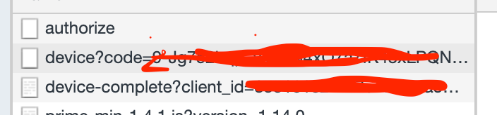

              We have the demo app for testing the device portion of the flow setup and it polls, it constantly gets HTTP 400 (authorization_pending). Which is expected until we call /oauth2/authorize, but after getting back the 302, we don't see this message change.
              When we test the out the box solution from Fusion auth this flow does work however. It seems the out the box solution does 2 redirects and we unsure if any of those steps adds to the authorize process.
