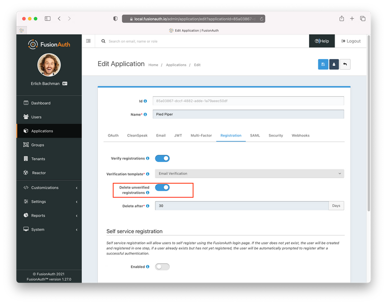

          Also, there is a policy for deleting registrations that are not verified. See application > registration
          If you have this enabled, it may be the source of your troubles as well.

              Unverified Users
              You are allowed a user-specified amount of time before the delete action occurs. One thought would be to set a longer timeline, such as say, 90 days, and have a script/chron job that runs through our APIs to track/validate/process the unverified users before they are deleted. Or you could keep unverified users in your application and periodically run a script to capture and act on that as well.

                Thank you so much for all the help. I have disabled the auto delete function for now. I believe the best way to have auto delete unverified users action enabled is to force a user to verify their email before they are allowed entrance into the app.
                Thankfully such a functionality is pretty easy for me to enable on the front and backend of the app.
