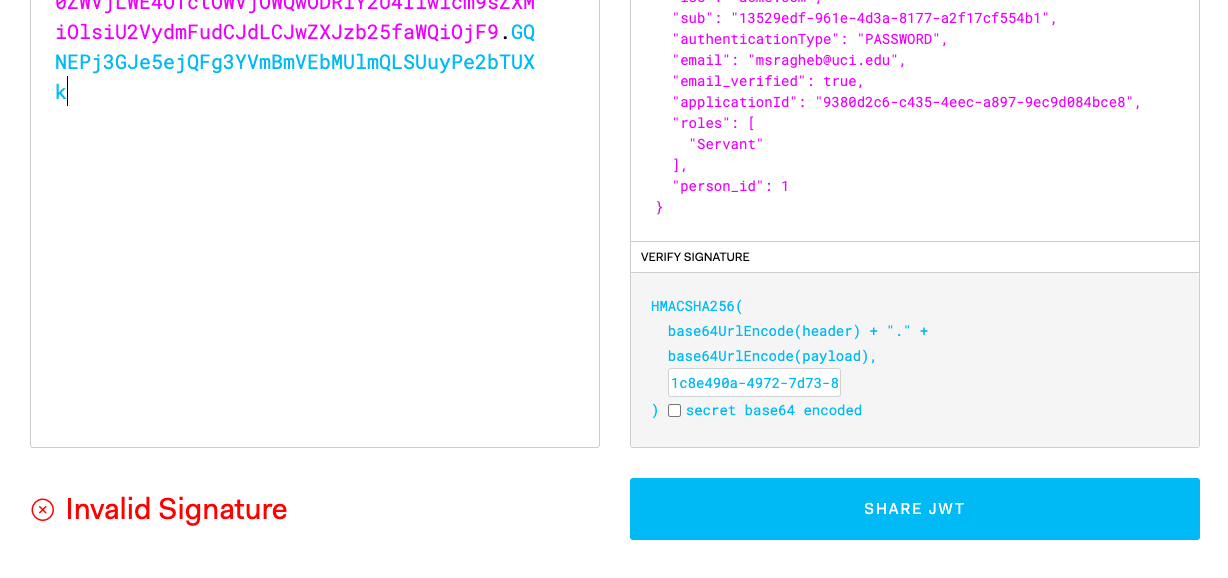

          I don't think it's an issue with server time. I can't verify the signature on jwt.io when using my secret and token.
          Here is the long lasting token:
          eyJhbGciOiJIUzI1NiIsInR5cCI6IkpXVCIsImtpZCI6IjllZDRjNjc1NCJ9.eyJhdWQiOiI5MzgwZDJjNi1jNDM1LTRlZWMtYTg5Ny05ZWM5ZDA4NGJjZTgiLCJleHAiOjE1OTQ1ODU2ODYsImlhdCI6MTU5NDQ5OTI4NiwiaXNzIjoiYWNtZS5jb20iLCJzdWIiOiIxMzUyOWVkZi05NjFlLTRkM2EtODE3Ny1hMmYxN2NmNTU0YjEiLCJhdXRoZW50aWNhdGlvblR5cGUiOiJQQVNTV09SRCIsImVtYWlsIjoibXNyYWdoZWJAdWNpLmVkdSIsImVtYWlsX3ZlcmlmaWVkIjp0cnVlLCJhcHBsaWNhdGlvbklkIjoiOTM4MGQyYzYtYzQzNS00ZWVjLWE4OTctOWVjOWQwODRiY2U4Iiwicm9sZXMiOlsiU2VydmFudCJdLCJwZXJzb25faWQiOjF9.GQNEPj3GJe5ejQFg3YVmBmVEbMUlmQLSUuyPe2bTUXk

                I was able to successfully decode a JWT. From reviewing this thread, I think maybe the issue is that you are using the wrong secret. It seems like you might have accidentally been using the id of the signing key '1c8e490a-4972-7d73-8935-06621a0a6441' instead of the actual secret key.
                Here's how I found my secret key:
                • go to settings
                • go to keymaster
                • click on the green magnifying glass icon to view the default key
                • click on click here to see the secret.
                My secret looked something like this: n0EfufcUAuYM6199G3ffRp+YUVMPodabtlI/wT8oBYc=.
                Can you try validating your JWT with the secret found through those steps and let me know how it goes?
