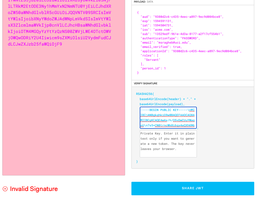

      Something is very wrong. I don't know if this is something anybody else is facing, but I changed to a RS256 key and used the public key on jwt.io and it is still invalid. I cannot validate a JWT outside of /api/jwt/validate. This is a really big deal to me to be able to do something as simple as validating. Please let me know if I am in error, but if I can't get this to work I cannot continue using fusionauth and that's a big bummer to me as I had high hopes for this service.

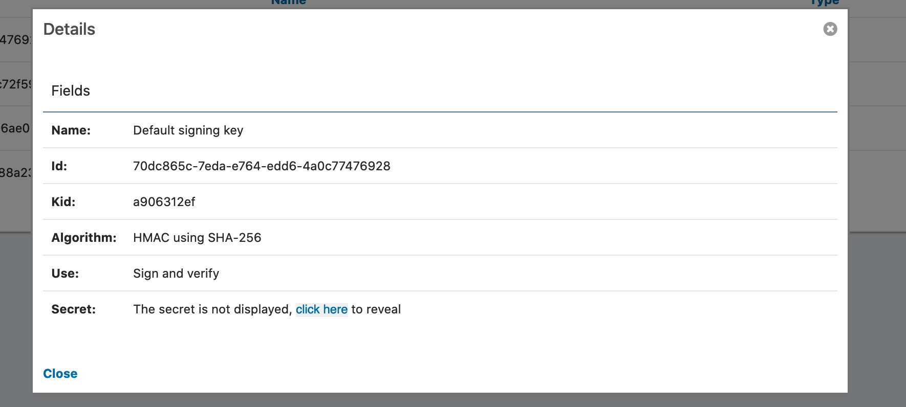

          I was able to successfully decode a JWT. From reviewing this thread, I think maybe the issue is that you are using the wrong secret. It seems like you might have accidentally been using the id of the signing key '1c8e490a-4972-7d73-8935-06621a0a6441' instead of the actual secret key.
          Here's how I found my secret key:
          • go to settings
          • go to keymaster
          • click on the green magnifying glass icon to view the default key
          • click on click here to see the secret.
          My secret looked something like this: n0EfufcUAuYM6199G3ffRp+YUVMPodabtlI/wT8oBYc=.
          Can you try validating your JWT with the secret found through those steps and let me know how it goes?

            Thank you so much Dan, that was exactly the issue. I successfully verified a token with that secret. I appreciate it very much.
