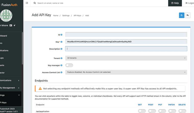

      Hi, via admin UI (its fresh install there is no api yet), i don't need to fill anything just hit save and ti creates the error, I pasted above.
        dan @j.smutek
        @j-smutek Hmmm. I just stood up a docker instance, went through the setup wizard, logged in as the admin user and created an API key on this screen:
        I was unable to recreate.
        Are you using docker from the install guide?
        What operating system are you on?
        Does this error prevent the API key from being created?
        What does your .env file look like?
