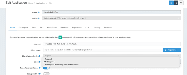

          mark.robustelli
          @yves said in OpenID Connect doesn't fallback to non-PKCE if provider doesn't support it:
          How can I (just for testing) force disabling PKCE?
          Have you tried to update the PKCE setting in your applicaiton?
          Y 1 Reply Last reply Reply Quote 0

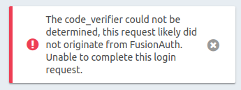

            yves @mark.robustelli
            Thank you for the pointer @mark-robustelli .
            However, also with this setting, I still get the following error message:
            What am I doing wrong? Is this not referring to PKCE? Is this referring to something else? Where could I get further debug info? (Unfortunately the event log is empty.)
