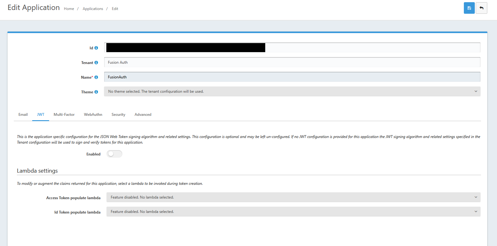

            @mark-robustelli Thanks for this. We don't have the setting Applications -> FusionAuth -> Edit -> JWT -> Refresh Token Settings -> Refresh Token duration , and I can't enable JWT on the FusionAuth application.
            Did you mean the Oauth tab in the tennant? That is currently set to 3600 seconds, but I find I'm still logged in to the admin panel after well over an hour of inactivity.

                rachel.flatt @mark.robustelli
                @mark-robustelli Thanks for your help on this. I've attached a screenshot below. I am unable to enable the JWT settings - the toggle does not move. Screenshot 2025-12-18 104426.png

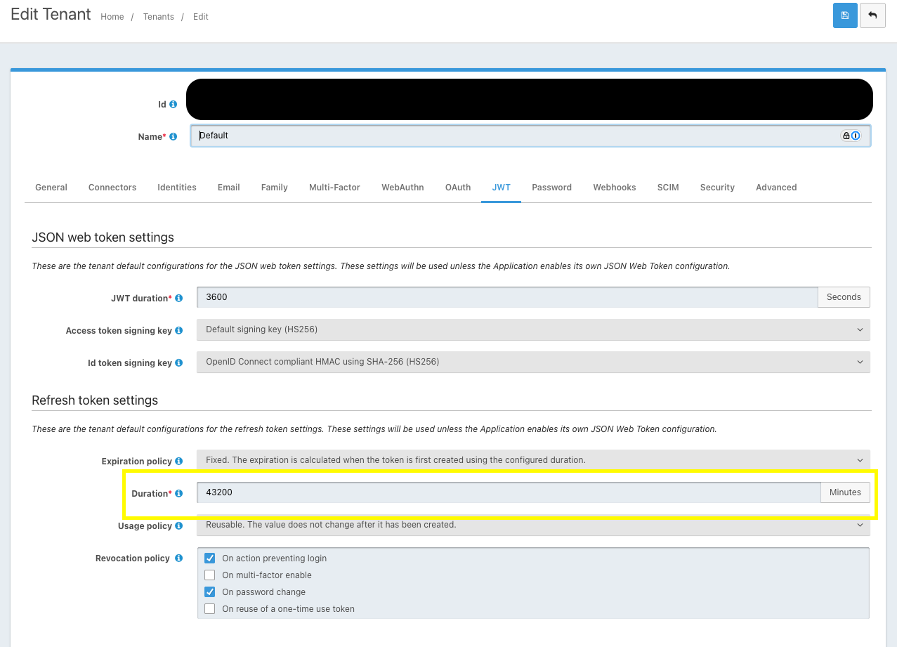

                  mark.robustelli @rachel.flatt
                  @rachel-flatt OK, it looks like your application is using the JWT setttings from the Tenant. You can go to the Admin UI select Tenants -> Find the tenant your application is under -> Select Edit and go to the JWT tab. You should find the settings there.
                    @mark-robustelli Thanks, I think that's resolved it!
