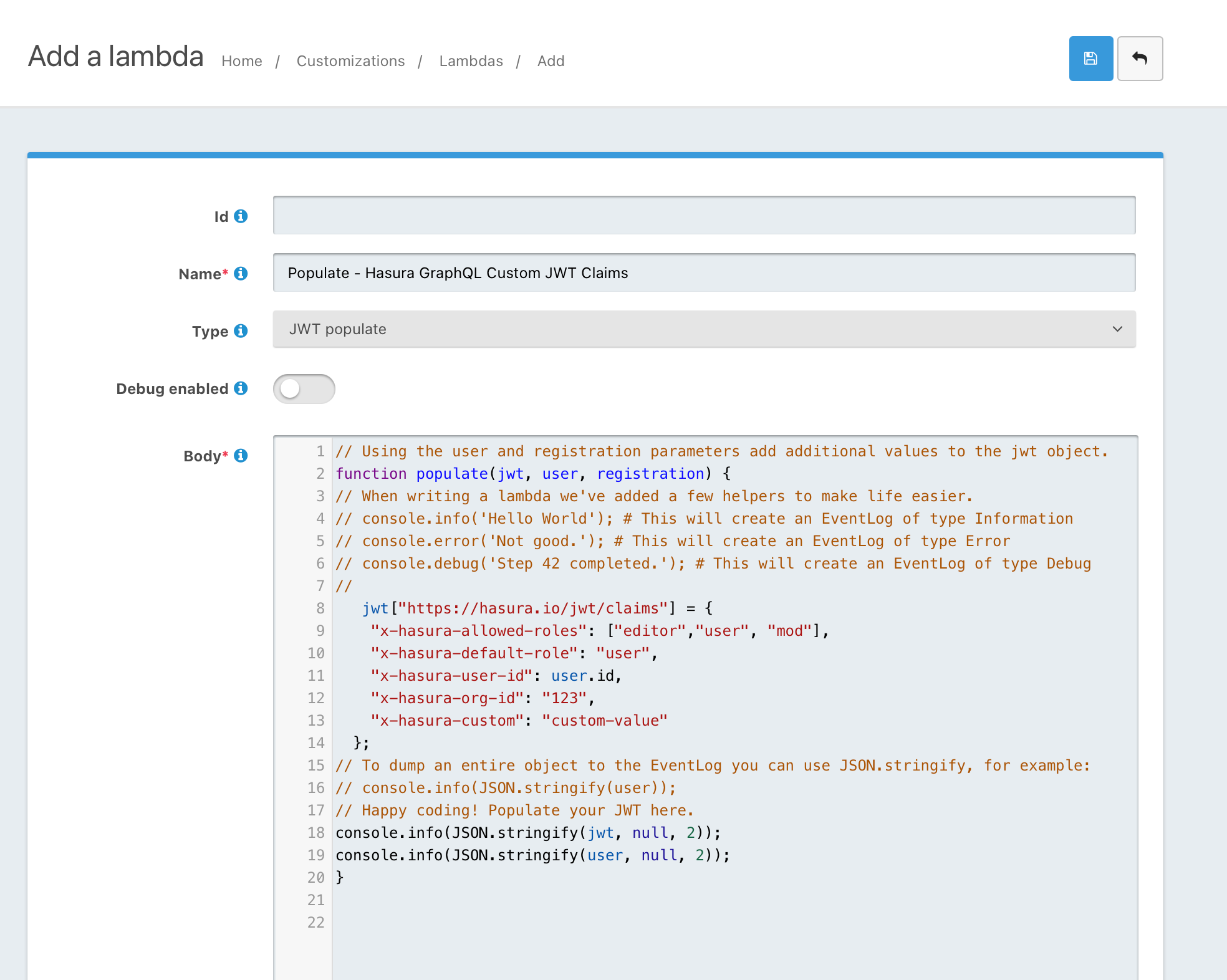

      • Create a Lambda function on FusionAuth to add Hasura claims to the tokens you issued. It's pretty much covered on this GitHub issue
      • To do that, go to https://fusionauth:9011/admin/lambda/
      • Add a new Lambda function with a name you can easily recognize later like "Populate - Hasura GraphQL Custom JWT Claims"
      • Leave ID empty, as you should always do 🙂
      • Select JWT Populate as the type
      • Add @robotdan's code in the code area
      // Using the user and registration parameters add additional values to the jwt object.
      function populate(jwt, user, registration) {
      // When writing a lambda we've added a few helpers to make life easier.
      // console.info('Hello World'); # This will create an EventLog of type Information
      // console.error('Not good.'); # This will create an EventLog of type Error
      // console.debug('Step 42 completed.'); # This will create an EventLog of type Debug
         jwt["https://hasura.io/jwt/claims"] = {
          "x-hasura-allowed-roles": ["editor","user", "some-other-role"],
          "x-hasura-default-role": "user",
          "x-hasura-user-id": user.id,
          "x-hasura-org-id": "123",
          "x-hasura-custom": "custom-value"
      // To dump an entire object to the EventLog you can use JSON.stringify, for example:
      // console.info(JSON.stringify(user));
      // Happy coding! Populate your JWT here.
      console.info(JSON.stringify(jwt, null, 2));
      console.info(JSON.stringify(user, null, 2));
      • Roles are used in Step #5 below. You'll have to figure it out later by yourself depending on your needs
      • Save your function

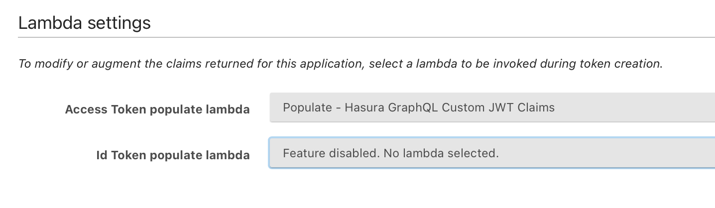

      2- Tell your FusionAuth app to use the lambda
      • Find your FusionAuth app here https://fusionauth:9011/admin/application/ and click edit.
      • Edit your app
      • Click on the JWT tab
      • Enable the JWT if you haven't before
      • Set Access Token populate lambda to your newly created lambda

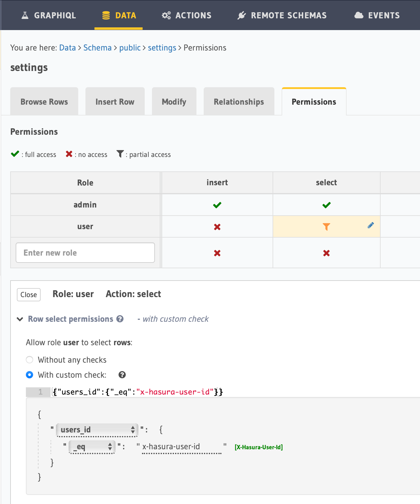

      7- Tell your Hasura how to use row or column level permissions for the tables you track
      • Hasura helps you to set row or column level permissions on the DATA page of its dashboard. Find your table and set select permission as it described in this tutorial
      • Basically, add your user group, and set your permission to check the user-id set in the request's header.
      {"users_id":{"_eq":"x-hasura-user-id"}}
      • Here, I set "user" role permission on my app's user "Settings" table we store user-specific settings so only the user in auth header could get the data that strictly belongs to him/her
