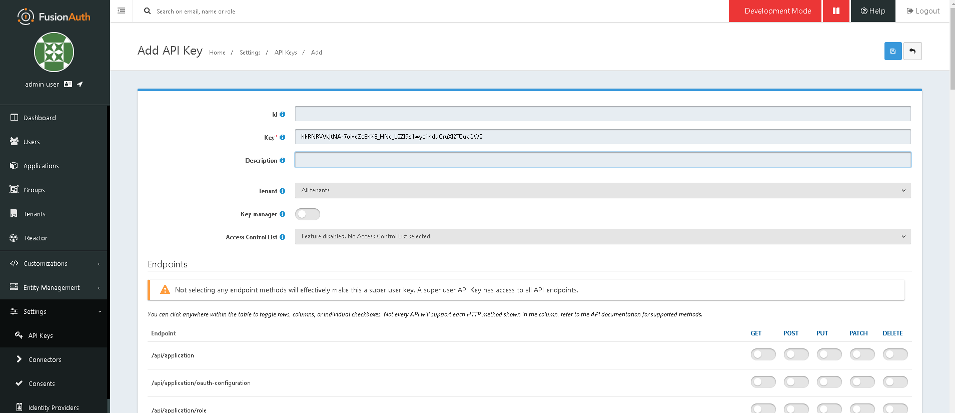

                Here is more info that could help.
                Api key creation screen:
                After clicking on save, end of url changes to "/admin/api-key/add" with ERR_EMPTY_RESPONSE
