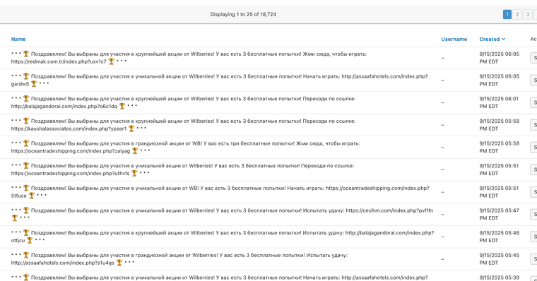

              @dan It is like that. They use regular /oauth2/register flow to create spam accounts. Even though we deploy WAF, it usually can't catch them as they obey the rate-limits. Screenshot 2025-09-15 at 6.09.30 PM.png

                @atakan @theogravity-sb Seems like two different issues here.
                @theogravity-sb is talking about attackers using the Google identity provider to create accounts with malicious names. @atakan is talking about attackers using self-service registration to create accounts with malicious names. They seem related but not identical. When you are allowing people to create their own identity and/or delegate to another source of identity, you decrease friction but give up some control.
                The bad news is that FusionAuth has nothing out of the box to stop this behavior.
                The good news is that you can build an integration to stop it. There are email verification services that give you a risk factor for email addresses and you can check that before you allow for registration or login.
